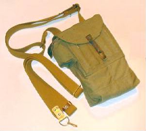

The Russian AK-74 magazine pouch, featuring four cell design, with side pocket for oiler bottle and four stripper clip front slots. Side pocket flap is cotton while the tabs for main flap and inner right front cell are brown leather. Both brown, black and natural leather examples exist. The overall webbing material is a medium weight cotton textile. Flap inner side stamped with inkstamps. Hardware (tab thorns) are natural brass. The cleaning kit is of the metal tube type, and the stripper clips are displayed with the loader (1) in place on the lead clip. The oiler bottle is black plastic, with the raised emblem of the Izhevsk Arsenal (Arrow-in-Triangle) molded in.
MAGAZINE POUCH:

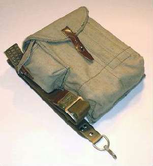

Standard Russian production four pocket pouch, this example dated 1993. Stripper clip slots have been lengthened to reach below the bottom reinforcement sew line. The oiler bottle side pocket has a cotton flap, while the tabs are dark brown leather. Some versions have leather oiler pocket flaps. Both black and brown leather versions exist. These pouches have varied little in color since their inception, most being a light green, and there seems to be no chronological order for some being dark and some lighter, other than the lot of the materials. Inside of main flap is normally stamped with white or black Russian manufacturer's inkstamps, which often include "OTK" and date. Most have a very high quality fit and finish. Brass tab thorns are standard.
RIFLE SLING:
This is a late pattern Russian AK sling, with D-ring snap hook on one end and the captive belt buckle on the other. Finish of the hardware is either zinc dichromate or cadmium plating. The web material is the traditional tight weave cotton. Loop material is of dark brown leather. Some late model slings have pebble textured leather. Slings almost always have white or black stencilled Cyrillic manufacturing emblems, or military contract data, stamped into the backside of the web strapping, to include in some cases, legible dates.

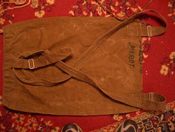

When soldiers were running around in the field, they needed something to put all their stuff in, and hence, were issued backpacks. But, the Soviets seemed to use the same kind of pack from WWII until the end of the empire...
So, when no markings are present, does anyone know how to tell the age of a pack? Perhaps by the material, stitching, hardware, etc?
Here is an example, can anyone venture a guess as to its age? (And if anyone can tell me what the writing says, I'd be grateful for that as well).
The difference was, the later models had a small pouch on the outside with a leather surround and clear plastic "window". I have one of these have been reliably informed that this was the only difference from the WWII model.
