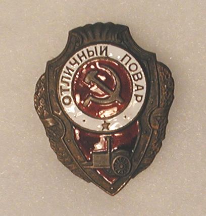

This 1943 "Excellent Cook" badge is a very detailed coined fake with high quality hot enamel. However in comparison with the original it is flat, laurel leaves around the shield lack detail, screwpost and screwplate are from a late Soviet badge. Fake patina on the badge and the screwplate is obvious.

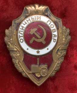

Here's an original badge for comparison:
Just to make a point: the badge on the left is an original 1942 issue piece. The one on the right was made in the 1950s, and is also an official issue. Both are perfectly genuine.

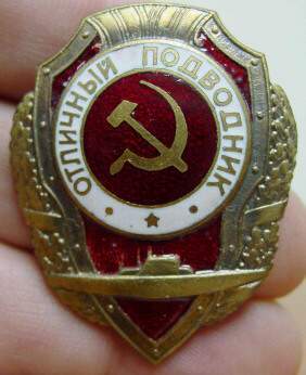

A sub badge from the 1950s should cost about $100-150, but will be tough to find even at this price. An original WWII issue would cost $300+, but I haven't seen them in a while.
If you are looking for GPW issues, the first thing you should check is the screwpost. So far all the copies I have seen had smaller diameter screwposts.
I have just seen a bunch of very good fakes of GPW Excellence badges, among them Cook, Submariner, Torpedo Operator, Baker, and Pontoneer. They are very detailed stamped copies with nice patina, but have modern Russian screwposts, and absolutely no traces of wear.
