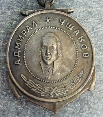

How about this Ushakov?
One more close up, the closer I get the less I like it :(
#82
pquigley Wrote:One more close up, the closer I get the less I like it :(
And you are right, unfortunately :thumbsdown

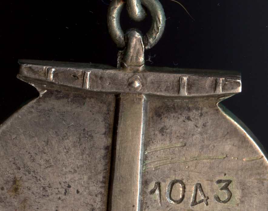

#83
I can't tell if these are real or not...to the novice (me) they look good...please help! Also, if they are not good, could you tell me why and what to look for in the future?
#84
Golden Age,
I do not like the medal.
Figures of the serial number looks wrong, the line on the anchor looks wrong.
But better pictures of avers are always a help.
best regards
Andreas
#85
Sorry golden age,
it is another obvious fake. These fakes (Nakhimov and Ushakov) did not comply the 'first lesson' ( first lesson if you need a genuine N. or U. medal).
#86
Progress
thank you for the input. I hate to ask, but what is the first lesson?

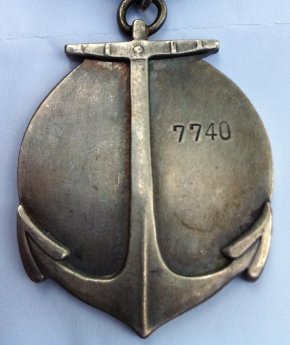

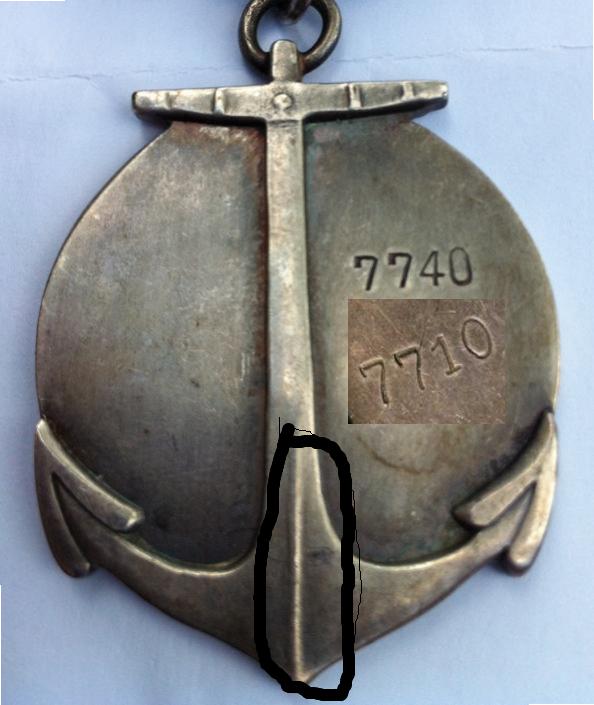

Gents, your opinion please...
Uneven dots?
Serial number too deep?
Spine to strong?
#88
The admiral seems to have lost his shoulders
#89
USSR Wrote:Uneven dots?
Spine to strong?
... flukes are to pointed;
punch is to unreal;
die is to wrong.
#90
USSR Wrote:Gents, your opinion please...
Uneven dots?
Spine to strong?
Not even close.
