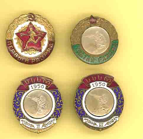

I have seen many versions of military sports badges that are similar to medaldude's. I can't comment on the fake/locally made issue, just that there are a lot of them. I collect shooting awards, among others. Here are three of them, along with a fourth sports badge. The top left is quite similar to medaldude's, except for the sport. Also, my screwplate is different and carries a maker's mark and "Moscow" (in Cyrillic).
I suppose this could just be made up from something like the center of the bottom badges attached to a generic award, but I think it is more likely that it is genuine.
