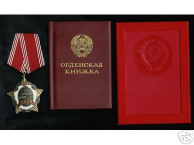

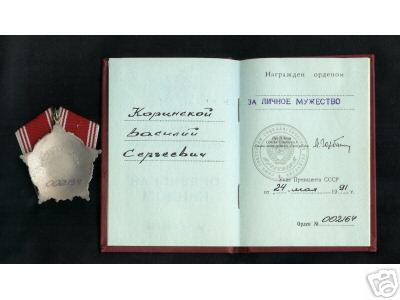

#25
Alexei, Christophe,
This Personal Courage looks somewhat familiar, could it be from the same dealer in Berlin?
Awarded to Vasilij Sergevich Korinskoj on the 24.05.1991 for Personal Bravery does this match?
#26
Difficult to answer.
Mine booklet is, according to PMD, a variation 6. The one you posted is a variation 7 (the latest variation).
If it is a genuine one, its SN seems to extend the range of awarded OPC's SNs.
Alexei, any comment ?
We would be interested in benefiting from your expertise and knowledge.
Ch.
#27
Christophe,
I should have added that the sellers address is in Berlin, thats what made me wonder if it,s maybe the same guy.
The variation 7 could fit with the award Date 1991, if it,s OK then it must be one of the last issued.
Eddie

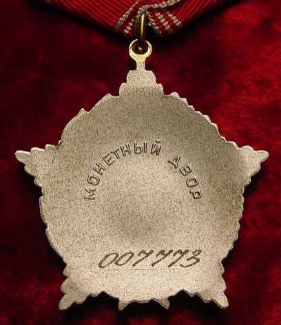

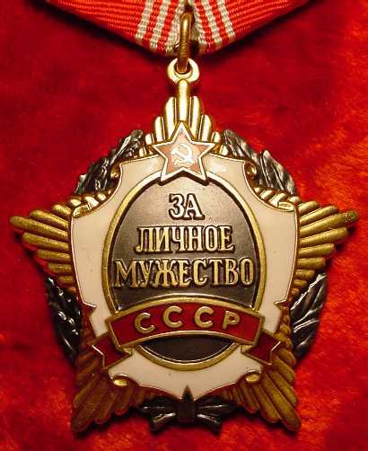

#29
Just for reference an authentic order of personal courage Var 1, unissued.
#30
Ron,
Nice piece :)
Alexei
