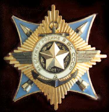

Authentication of a 1st class order of Service to the Motherland in the Armed Forces Set (!)
At first, it seems odd that no one payd attention to it. But after close examination of photos in the books (McDaniel, Shishkov) It is so simple!
The words in the order are wtitten inside white enamel. i
n the 3rd and 2nd classes, the colour of the letter is silver.
In the FIRST class it is gold.
If I was offered a piece claimed to be 1st class, I'd test one letter - if the gold color stays.......:D and if not - :mad:
It is impossible to alter completely and perfectly the color of the leters if they are surounded by the enamel!!!!!
Tal
#14
Tal,
This seems like a good idea, but on a second thought - aren't first class orders made the same way the fake first class orders are made? From what I heard, they gold-plate the silver parts in a 3rd class to make a 1st class, which is exactly what the forgers would be doing anyway...
Just a thought. It's a good idea though... :)
#15
Mahdi,
To apply gold plating on large surfaces, with no enamel surrounding the metal is simple. BUT, the letters are INSIDE the white enamel, and gold plating theme will be very hard.
I think that this part in the order is different in the 1st class, and in the process at the mint the letters are cast in Gold color or are made from copper. other parts of the order are exactly like 2 & 3 classes, with additional areas covered in gold.
I contacted Paul McDaniel about it, and let's wait to hear his response.
Tal
Letters in silver:
Letters in gold:

Having jumped into this thread in the middle, I feel I can offer an educated opinion..this award, Order for Service to the Motherland 1st class, #09 was purchased by me as a special order for a very good customer. It was expensive to say the least and not something in my personal collection. The award was authenticated by McDaniel and it is an early issue/manufacture. I have excellent 300DPI images of this award, they are 90K apiece. If someone wants me to selectively crop part of the image for a real good closeup let me know.
Art

I apologize for jumping a touch backwards in this discussion, but I am affraid that Tal's authentication test is doomed to fail.
The round center piece with the writing on it is actually struck in one piece, meaning that the letters protrude from the bottom of a groove that is later filled with enamel. The enamel is then fired, and the piece is polished, leaving smooth, flat enamel, the letters and edges all being smoothed down to the same level.
Electrolytic plating (which is what mints worldwide use commonly) requires that the surfaces to be plated be electrically conductive. Since the piece is struck from one piece of metal, all that is needed is to connect ANY part of the piece to plate to the plating machine. Plating does not adhere to enamel, so it is definitely not a problem to "upgrade" a 3rd class to either a 2nd or 1st class.
Just to keep everybody sweating, all the equipment is readily available :( : for enamel, you just need a small electric oven that would probably set you back about $500, and plating macjhines can readily be procured from about $350 upwards (for those on the forum familiar with Japan (hi Dave!), all the above, plus any type of supplies is available at Tokyu Hands).
So, if you stop and think of it for a second, it is actually relatively easy to replace missing enamel with actual glass enamel, replating is likewise fairly straightforward. The only drawbacks are to find the exact matching colors for both the enamels and the plating, but trial and error should bring any serious would-be faker pretty close to the real thing.
Sorry if I sound disturbing, but I believe that there is a serious need for all serious collectors to have at least a minimum level of understanding of the manufacturing process, and its potential pitfalls.
