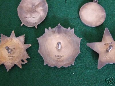

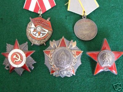

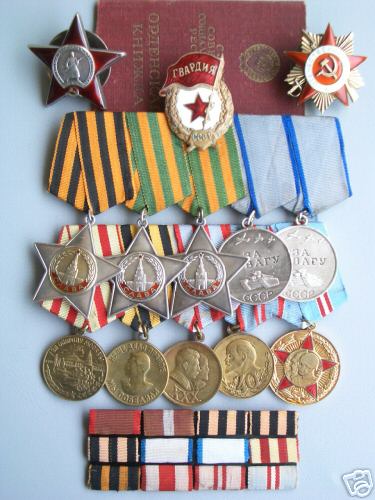

Interesting Set
I have my doubts about this set:( Too good to be true me thinks.
Just as as an outside issue here. This soldier should have and would have been entitled to be a Full Cavalier of the Order OF Glory;)
What's some thoughts on this one. Interested to hear from the big 2 here, Alexei and Paul;)

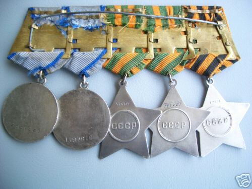

I should voice my doubts on this group.....
  1. The ribbons on the Glory IIIs are......well what are they? I haven't seen this colored ribbon before, certainly not on GloryIIIS
  2. The rings on the middle Glory III and II are suspect.
  3. The engraving of the numbers, on what I can see is also suspect and don't compare to the number ranges of 'real' Glories.
  4. The depth of the engraving for the number ranges are suspect.
  5. The document itself I would suggest is false, though I am not an expert on documenation.
  6. A Cavalier Group for 1k.......I don't think so.
  7. Most soldiers who were awarded a second Glory III handed them in at the end of the war or later when they found out they could hand them in and be upgarded to II and I Orders of Glory did so.
That's just to name a few issues I have with the Glories, which are the focal point of the group.

I just noticed the ribbons....:laff
I feel it's pretty safe to declare this an assembled set. Yes, it did happen that soldiers were awarded repetitive Glory IIIs in the field, but the #749.xxx one would have been awarded way after the war and they would have had time to "unscrew" the multiple awarding situation.
If I had my s/n database handy I'd look up all the awards to see if they were even from the same front or army, but at first glance this set looks like someone took a bunch of awards, wrote them in a real award booklet, and then is trying to sell the set as belonging to one person.
Green ribbon for the glories is wierd...
This guy sallying weekly sets on ….. And all of them fake 99%
In my opinion just 2 first entries in this book is original (my oldest comrades can correct me if I am wrong)
