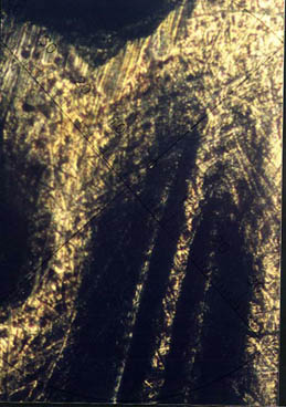

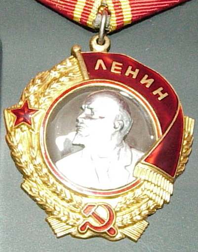

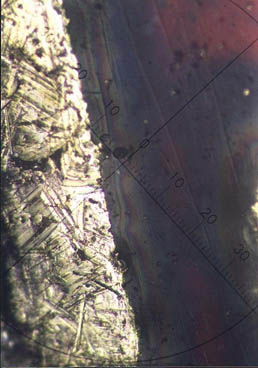

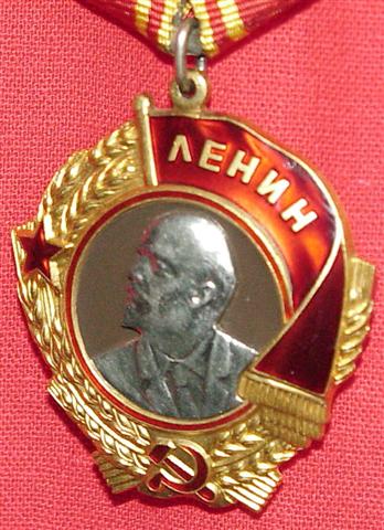

I want to show you more pictures of award "Lenin".
You should pay attention as the edge of hot enamel around of gold surfaces burns down at melt of enamel in muffle furnace (pic. 1). Also, I want to show you how the edge of award can be grind off by a file (pic. 2, 4) and that gas-bubbles remain inside the red enamel (pic. 1, 3)
