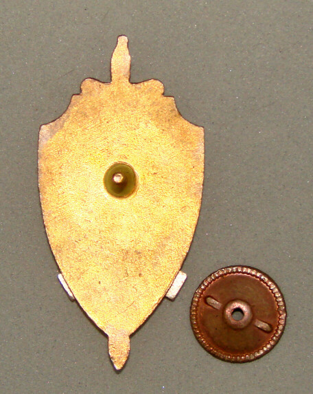

Here's an MVD Academy graduate badge from '74-'91. Leningrad mint mark on the badge's back; unoriginal tightening wheel.

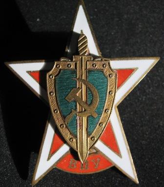

Another badge in the same vein as the last, also of brass and hot enamel but without mint mark and with a smaller screw. This is a commemorative badge of the military/political school (VPU) from, I suspect, the mid '80's.
