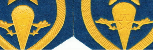

I recently noticed differences in the detail of the parachute canopy and the size of the Soviet Stars on a couple of the VDV patches in my collection (See Below). I presume that these minor differences are just manufacturers' variations. However, I would be grateful for your comments regarding them.
Regards,
Jim :confused:

I presume that these minor differences are just manufacturers' variations. :
I don't understand your first question. Wall posters were intended to show proper uniform wear and identification to a unit's personnel. Order of Battle is usually a line-and-block chart showing an army's or unit's composition. I don't see a correlation between the two.
Question #2 - yes. These were made in the gajillions by many factories.
