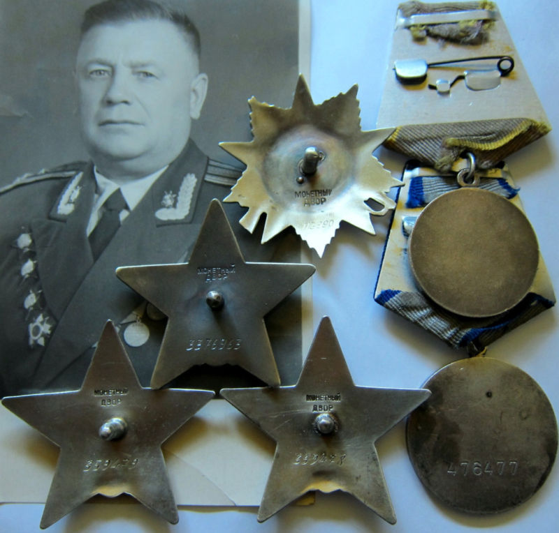

i am looking at buying this group, but would like to get options first as it seems to be a naval group with 2 of the RS have consecutive numbers and seems like they are not long service. i find this an interesting group as seems like its not often good naval groups to officers come around

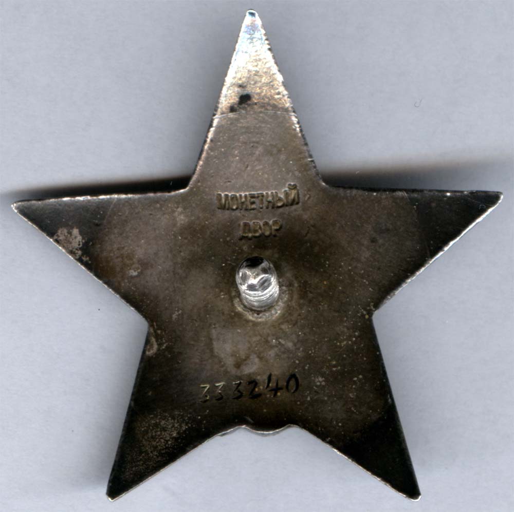

I would like to see the obverses but I really don't like the consecutive Red Stars and the OPW.
I don't like two RS shown, seems like the back of orders was polished ones
Yeah, the Red Stars look like they were polished and new numbers potentially engraved.
Yes, serial number engraving of the two Red Stars looks strange.
Roter Stern 0.333.240 r.jpg Roter Stern 0.356.967 r.jpg Roter Stern 0.365.200 r.jpg
cheers guys i had the same line of thoughts as back of the stars looked to new and all the numbers on the 3 star look as they were done at same time
