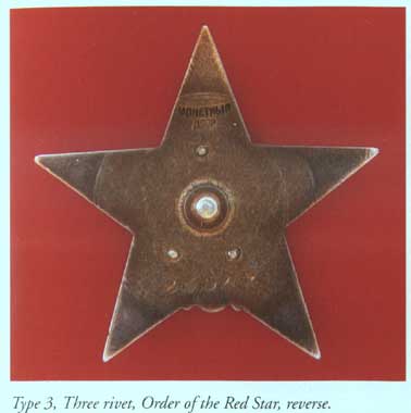

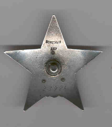

Hi
I have an Order Of The Red Star.
In looking through thr variations it doesn't seem to fit.
It is curved, with a large mint mark that is straight on two lines with the mint mark being dark & deep and the ABOP being light.
I thought it was a type 2 but the mint mark is not curved, (even slightly). the serial number is strange as well; it goes 10321?1.
The second to last number looks like an f or maybe a 7 with a small line?
Any ideas would be appreciated
:confused:
Hi,
There actually many minor variations of the Red Star - curved, concave, flat, thin, thick, etc., and many mint mark variations. Looks like you have one of them.

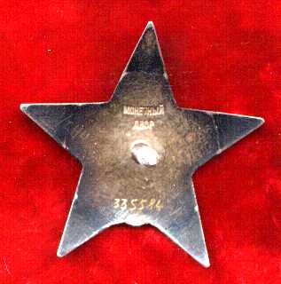

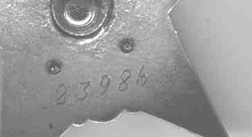

The early Red Stars were hard earned. This is my 5 digit, red star probably Finnish War. Note it has an earlier number than observed by Paul McDaniel.
The enamel is in perfect condition.
Here is a close up of the Number and Mint Mark. Eyeball wise the number is sharp.
The mint mark is close to the rivet, the rivet is in the correct place.
I see no marks of erasure to alter mint mark or serial number area (the area is not smooth).
However I believe this forum should be used as a tool to warn others and if you think this is fake, point out its errors or suspicions for others education.
regards Chris

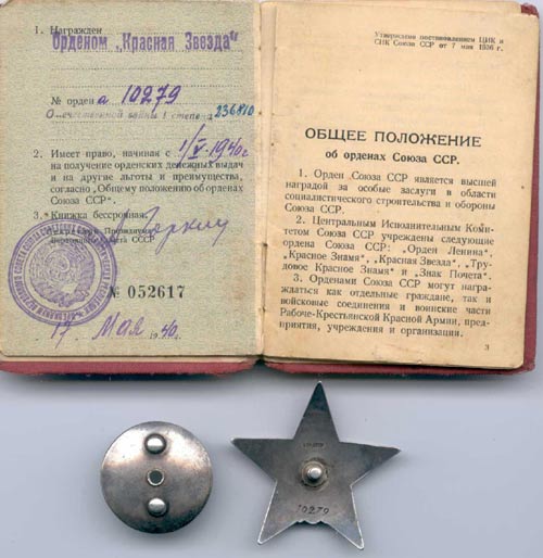

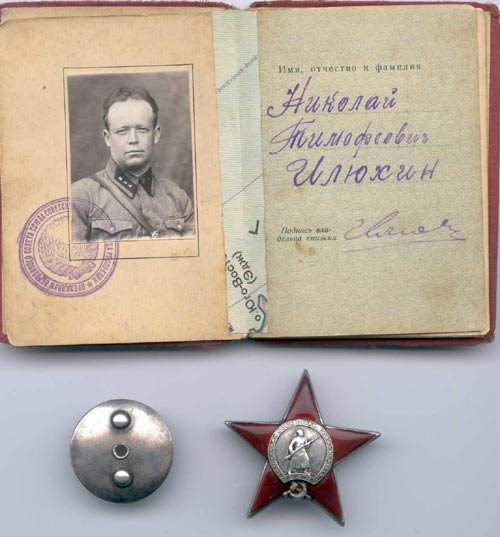

Here it is. The etching is hardly visible because of the patina, but there is a date, name, and the operation it was awarded for. This Red Star is part of a documented group.
Alexei

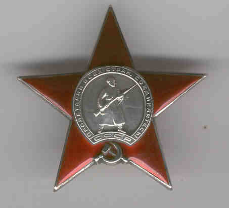

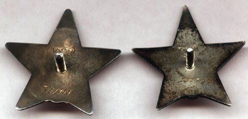

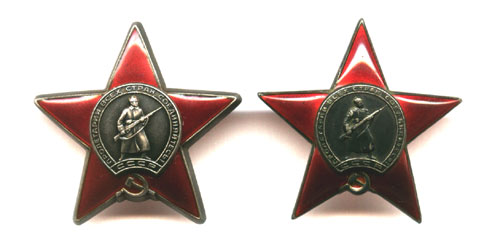

I picked this up this week..The Red Star on the right, #556788, weight 26g, average of 47mm from star tip to tip, 3.6mm screwpost..the enamel ends almost exactly flush with the edge, very very small flared edge..anyone see something like this before or am I just looking at this thing to long? Note full flared edge star on left.
[/SIZE]
Art,
you sent me 2 smilar Red Stars with the "Kandybin-group". The right one - sharp and pointed - is WW II production and the left one - not so dangerous - is a post WW II production. I have also 2 other pointed and not-pointed Red Stars in my collection.
That's my modest theory.
Regards from Vienna
Hmmm, I must have been looking at it from a strange angle. Well, into the Serial number database it goes!
