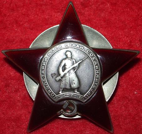

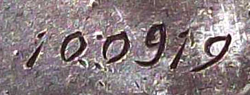

Hello guys,
Could anyone specify their dates? I could find only a table showing YEAR for specific serial numbers, not MONTH.
Is it at least possible to tell whether a piece is from WWII or postwar? thanks.
Arez Wrote:Could anyone specify their dates? I could find only a table showing YEAR for specific serial numbers, not MONTH.
It is not possible to specify such exact dates and I don't know what table you are referencing. Awards were issued in bulk to a "front" or large operational unit and then awarded to subordinate units. The best you can do is an approximate year, if not season, but the only way to know the exact date is to research the piece.
#1.661M would be WWII-era. I have several #1.663M on file that were awarded for the Soviet campaign against Japan in late 1945.
The other one #1.415(?)M is also WWII era. If it is #1.415M, it was awarded by 4 Ukrainian Front.
Most of the numbers in this range are engraved a little bit childish.
