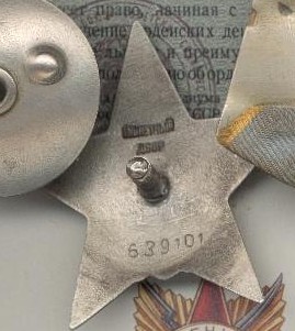

What do you guys think of this serial number?

Rusty,
Hard to tell for sure, looks like there is some polishing around the number, but it could be just the angle.

The reason I ask:
It's currently on E! as part of a group...
To me the numbers look funny... with my limited exposure I have never seen this style on Red Stars...
So I was figuring it was made to fit the Orders Book.

Rusty,
Unless he has an iron clad money back guarantee I'd pass.

Rusty,
I was the "lucky winner" of the Red Star that you posted.
It has indeed been modified. The amount of medal that has been removed to erase the old serial number left a noticable indentation under the new serial number. Actually I don't think much of the new serial number either.
The only good thing is that the seller will take the group back.
Wish I would have seen your post BEFORE bidding.
