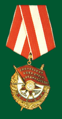

I´d like info about the relation between serial # & fabrication dates of Orders & Medals. Particularly I´m interested in dating Order of Red Banner T2/V2 #75.583, Order of Red Banner T4/V1 #483.837 & Order of Red Banner of Labor T5/V2 #300.992.

Order of Red Banner T2/V2 #75.583 - august- december, 1943
Order of Red Banner T4/V1 #483.837 - 1963 - 1968
Order of Red Banner of Labor T5/V2 #300.992 - 1954-1955
