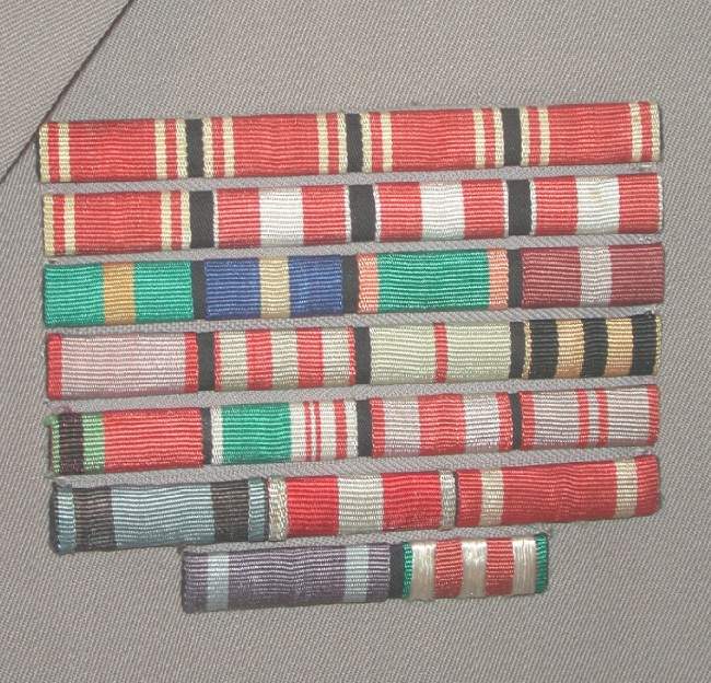

Here is an example for a very impressive set of ribbons, belonged to Gorskov:
Thanks Tal,
I was hoping you were there :) if this guy had to wear all those awards..good luck. He'd need a back brace.

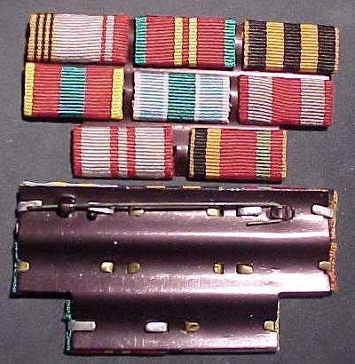

Here are 3/4/5 ribbon wide sets.
Hi, I guess this may be a little late, but I thought it may be useful. To answer the question about ribbons, depending on the type of the uniform and the size of the person, the number of adjacent mounted ribbons may vary between 3 and 5, each of which is the same width as the ribbon on the actual medal/order (if present). Moreover, their order would be as follows (skipping any awards that the person was not presented):

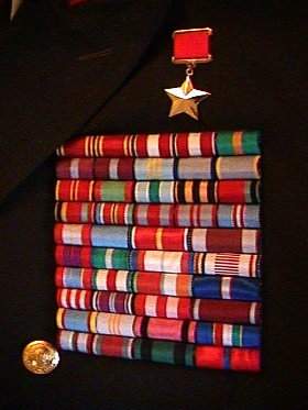

Some veterans do have a lot of awards...:
Indeed some do, but in the picture that Tal posted it is important to mention that:
1) The awards are not worn on a military uniform, which usually has slightly larger surface area for attaching awards.
2) The awards are not worn according to the Ministry of Defense regulations, thus using the "space" less efficiently.
This makes the awards seem like there are many more than there actually is...
But Tal is right indeed, some veterans do have a whole lot of orders, medals, and badges.
