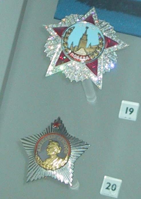

The Monty's awards showcase. His Order of Victory is on the left, just above his Suvorov 1st Class.
Monty's order of Victory and Suvorov 1st Class.
One more time, sorry for the quality of the pic.

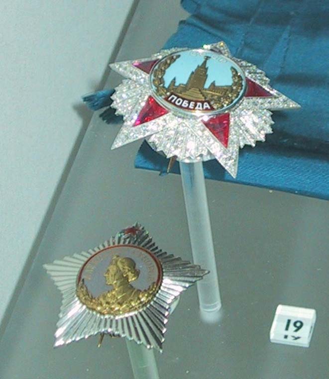

Slightly different angle.

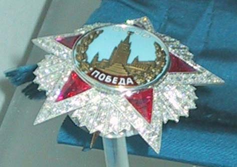

And here, on this pic, you can see that Monty's Order of Victory is a pin-back version and not a screwback one.
That's an interesting point, as we know that - except Brezhnev's one - all Orders of Victory are supposed to be
screwback versions. (see PMD page 49).
What is interesting to know is :
* Is Monty's Order initially a screwback version modified ? Or has it been made initially as a pin-back ?
* If modification, where has it been made ? In USSR or in England ?
* Is the screwback system coexisting with the needle in the back ?

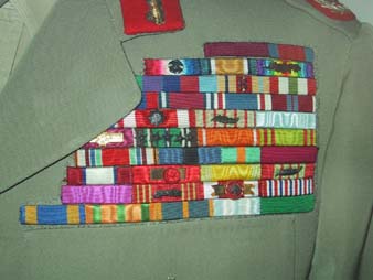

The Order of Victory's ribbon is in the 7th rank.

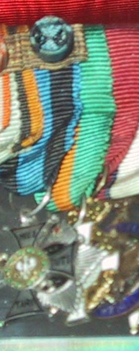

Montgomery's miniature bar, including the Suvorov 1st Class.
"Small' Suvorov as part of his bar;
Sorry for the quality of the pic, but it is interesting to see how he mounted this screwback award on a bar.

It appears that the Suvorov1 is also a pin-back, so I would conclude that both were modified after the award ceremony.
I've seen several Russian soldiers modify Screwback to pinback.
Infect one of my friends has an Afghani Red Star that was converted.
Thanks again,
Rusty.
WOW!
It's the first time I see miniature of Suvorov order!
Such miniatures were made by jewelers and I am sure Suvorov 1st class miniature is certainly custom made. It looks like there's some sort of a loop on the back of small Suvorov to hang it on the ribbon.

William,
Loop ?
Difficult to see with precision from the pic, and not easy either in real because of the way and place where the bar is displayed.
But I agree, it looks like there's a loop on the back of small Suvorov to hang it on the ribbon.
May be the Curator will be able to help on this case too.
Ch.
They even managed to find correct small ribbon for Suvorov...
It's interesting to see that mimiature Suvorov's placed somwhere between Polish Virtuti Military and French Legion of Honor.
William
You probably remember that, when I visited the Imperial War Museum last September and made this report, I have asked several questions about Marshal Montgomery's Order of Victory (and possibly a pic of its back) to Mrs Diana Condell, the IWM's Curator, Medals :
* Is Monty's Order initially a screwback version modified ? Or has it been made initally as a pin-back ?
I committed to keep all of you informed of her answer.
I have received today an answer from Mrs. Diana Condell, and I take the opportunity here to warmly thank her for the help.
Her answer is the following :
"(...) Thank you for your further e-mail on the subject of Field Marshal Montgomery's Order of Victory.
I have now had an opportunity to check the files on this. The order of Victory is a brooch bar fitting. There is no physical evidence that there was ever a `screw back' fitting.
I am unable to give you any indication as to where the `brooch bar' was made except that it would probably be a fair assumption that it was presented to Field Marshal Montgomery in the form that we now see.
My own view, for what it is worth, is that the Soviet authorities may well have been informed, or perhaps made aware, that British uniforms have no provision for the wearing of insignia or medals fixed by the screw back method and may well have adapted the one presented to the Field Marshal accordingly.
Frankly, I think you will only find the definitive answer by checking with the Russian authorities. No photographs are currently available I am afraid.
Again my apologies for the delay in sending you a reply. (...)
Yours sincerely
Diana Condell
Senior Curator, Medals".
Ch.
It is very interesting to notice - in reading this answer - that this could lead to conclude that this order is, maybe, a new version of the Order of Victory...
And probably some of these Orders have been made in a customized manner...
Whatever, I'll try to investigate further, on the occasion of one of my future London trips. (I hope being able to get a pic of the back).
