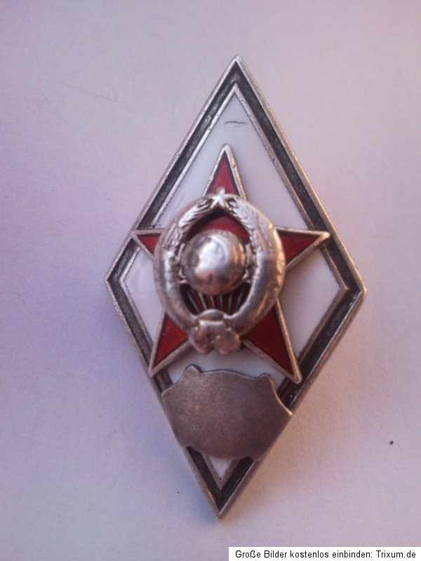

Hi,
this one`s curious - it looks good and heavily worn, but shouldn`t there be written something on it`s front plate :confused:
Jens
just too much polishing
It's a type 2 badge. So maybe the plate had already been affixed when the regulations changed in 1957, the name of the school had not yet been engraved on the plate . . . which makes it a true transition piece . . .
