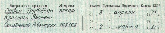

A fake entry for Order of the October Revolution in this Order Booklet. Hand-writing is consistent with some late Soviet sloppy entries, but this is one of the highest serial numbers for this Order ever observed, and it certainly could not have been awarded in 1981. Only the first entry is original.
Two scans of the same fake Order Booklet. The only original entry is the Order of the Red Star. Fake entries were made with diluted ink to make them look old. Photo is not original either. Note the highly irregular use of a military unit seal and a new looking ink. In fact this photo was stolen from Soviet military archives and when removed had the original officer's name written on the back.

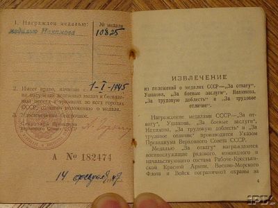

An original award booklet with fake entry for Admiral Nakhimov Medal. The ink stamp for Nakhimov Medal is fake, and is a little crude. They also added the following hand-written text: "2) Has the right since 02/07/1945" - yeap, that's what it says!
