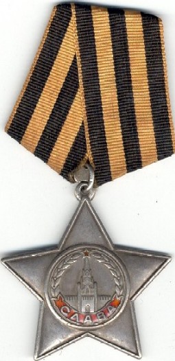

I want to share with you, a couple of my Glory Orders... a 2nd and 3rd class. These are currently pending research, which should be back in a few months.
What information can one get from just looking at the images? I can hardly wait to see what information comes back.
Here is the second class
Next is the Order of Glory, 3rd class. I can hardly wait to inform you of the results!

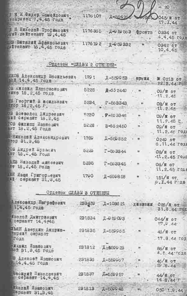

The other source - protocols of presentation. Probably you are familiar with this type of document. Here is an example. Compare the date of Prikaz for this Glory and the date of issue :)

Dave, those protocols are available from central military archive in Podolsk. I have dozens of them, trying to determine what number ranges of different awards were issued in which units (Armies, Fronts).
It seems that it's endless work, because so far I have just a tiny piece of information. But we have to start from somewhere, right? ;)
As you are interested in Glories, here is another protocol (part of it about Glory). I'm sorry for poor quality, but with a limit of 50kB there is only way to post it - is to reduce the size and quality of the image.
As you can see, the awerage time period between Prikaz (very right column) and date of issue (very left column, after the name and rank) for 3rd class is about eight month. Of course this is not a rule. In many cases this distance was only few days or couple of weeks.
