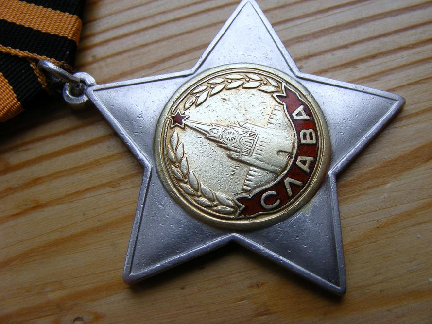

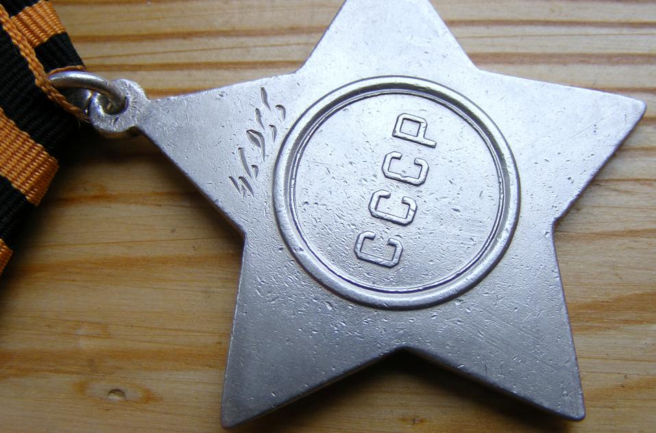

Having done the aceton cleaning as Pobeda45 suggested, I still had a bit of artificial patina left so in the end I went for siver dip diluted with water. Then another acetone wipe and two coats of clear metal lacquer by Rustin's (seems the easier one to find in the UK). Takes ages when you try to do it carefully. Anxiously awaiting your comments on the outcome :o.

Looks good, but patina is gone.
04-05-2012, 02:24 PM
And the lacquer will make things much worse over the long term.
04-05-2012, 03:00 PM
medals73 Wrote:And the lacquer will make things much worse over the long term. What does lacquer do? Sergei travel-north Wrote:Looks good, but patina is gone.True, my problem in this case is that the patina was three years old (the medal was cleaned or else extremely well preserved before I got it). So, we are back to the old debate: to clean or not to clean? ![]() Sergei
04-05-2012, 04:47 PM
For me clean (almost always).
Polish - Never! I've come across a great amount substances attached to awards that are far from natural. Grease, wax, plasticine, blood, tobacco smoke (and all the comes with it), animal faeces, sticky tape, mud, dust, metal polish and of course fake patina. None of which were ever intended to be displayed of someone's chest. Clean then store, if any natural patina occurs during storage that just means they are still being exposed to atmosphere. Most of the "junk" found on items can continue to damage the items. Specially if someone has been polishing brass or silver with polishes as they deliberate go green/black so you have to buy more polish and do it again.

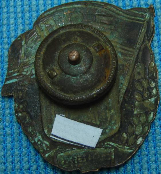

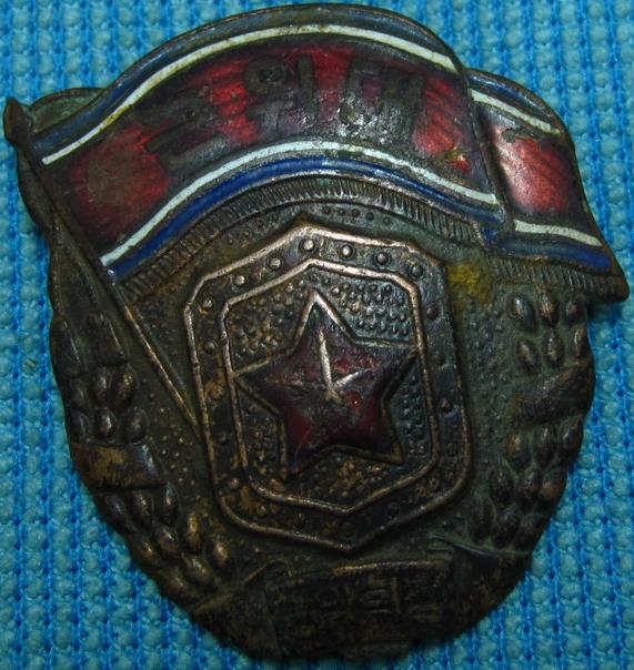

I use water (sometimes warm sometimes boiling depending on the junk that is present), liquid soap and wipe down with a towel (or similar fabric). Sometimes if the item has been ground dug or particularly neglected I will use a toothbrush or scrubbing brush depending on the item. Sometimes when something is particularly attached I try to scratch it off with a fingernail (a dry one not a wet one which becomes soft) as a fingernail may be metallic but is generally softer than any award.
On rare occasion, when I get my hands on a particularly abused copper based item it will get a light wash in malt vinegar. Care needs to be taken in doing so as plated copper items will soon have the plate eaten off if not careful (about 45 minutes to 2 hours depending on plate and temperature). This is just a one time measure though and I was any vinegar off as to make sure it doesn't keep eating the item. Don't mix vinegar and silver! Also don't forget that fingers are acidic too and human contact with the medallions is also not good for the metals. Here's an example. Here's before. And 6 months after "cleaning". http://soviet-awards.com/forum/soviet-bl...post163348 P.S. Also had paint and nail polish on awards.
