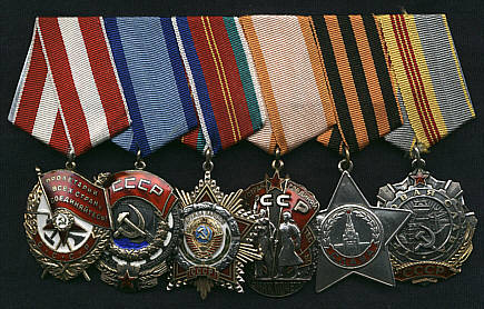

Thought I would share my lastest buy. I Just got this on May 24, at the Sam’s Military Relic Show in San Antonio, TX. I am 100% certain that this is not an original medal bar, due to level of prestige of these awards and for a recipient to receive all four of these labor medals without receiving any other intermediate awards would be kind of odd. Nonetheless, it is a handsome grouping with lots of detail, enamel and color. Starting from the left, the medals are:
- Order of October Revolution
- Order of the Red Banner of Labor
- Order of Honor
- Order of Labor Glory 3rd Class

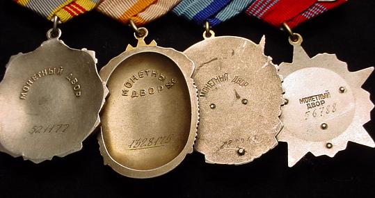

Here is the backside and serial numbers...
- Order of October Revolution #56788
- Order of the Red Banner of Labor #287963
- Order of Honor #1328175
- Order of Labor Glory 3rd Class #521177
The serial numbers would also suggest that this is not an original bar due to the large gap between the numbers.

october revolution: approx 1978
red labor : july 1954
honor 1983-84?
glory 3rd: 83-84?
no coherence between red banner of labor and the others; I find curious the mix between honor (cultural and education award) and classic labor...the revolution october must be the crown jewel of a labor career, so it'd be logical to find a labor glory and others given before october...
my opinion, sebastien
Sebastien
(a well-known german bearbed)
I think this is a fantasy group. I saw a lot of groups with this combination, NONE with documents.
Tal
I definitely don't get excited about bar-mounted groups unless there are documents involved...

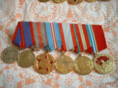

Here's a group that I mounted up for myself back in my early days of collecting Soviet awards just as an 'example' of Soviet awards (I had it on display in a frame and all.) I sold it just like that on eBay a few years ago, as a 'put together' group. God only knows if someone tried to sucker someone with it later!

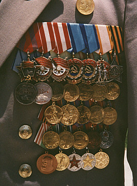

In fact, I don't trust any award group on a bar (unless it's really old and salty, even at that, I've still bought put-together bars!) unless there are documents! Here are a few examples of groups that I put together for a very well-off, but very novice, client back in the early 1990's. He didn't care about the whole research thing (or even them being real) he just wanted pretty uniforms with lots of medals (he'd specify exactly which ones, which was nice) and I'd build them for him! (He'd even send me some of the medals to include with the group!) Here are the results... I'm not proud of them (as they are nearly 'impossible' fantasy groups) but he was happy! :)
Let's just hope that he didn't foist these off on some novice collector as the 'real deal'! (That's why I don't do this sort of thing for people anymore!) :(
