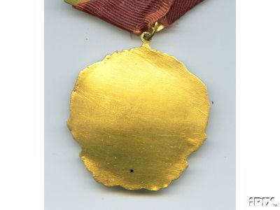

Dietrich,
Thanks a lot for the variations of the Dimitrov!
I came across this variation that really does not match any of the ones that you posted - the hole is on the bottom of the reverse.
What do you think of it?
The holes are there for a reason.
Earlier rare emissions were made out of solid gold (weight 66 grams), while later emissions orders were hollow (33 grams weight).
That's right - the awards were empty inside and holes were used in the process of soldering two pieces together.
Best regards,
William

#12
Here are some details of the hollow Dimitrov Order (weight 30 gram) that show the two-part seam-sealed construction.
The coined front of the order is sealed off with a flat back plate. The holes through the back of the order are added as vent or blow holes. When you heat a hollow assembly during seam sealing, the gases inside expand, lifting the cover and preventing a bond unless the gas can escape. The microscopic picture of a vent hole through the back of a Dimitrov Order (upper right) allows to see the thickness of the back plate.
The upper-left picture taken on an early version of the 2-part Dimitrov shows the seam and even some gaps in the seam. On this two-part Dimitrov, vent holes through the back plate would not have been necessary. However, the manufacturing process was getting better over time and the vent holes became more and more important. Late issues show hardly any seam.
The first-type, solid 63-gram Dimitrov Order has a single blind hole on the back (bottom picture). It was most likely used to insert an electrode for the brazing/welding of the hanger ring. This blind hole is always placed close to the ring.
The engineers at the Bulgarian Mint probably received an order themselves for saving about 33 gram of 14-karat gold on each Dimitrov Order by introducing the hollow construction.
Dietrich
