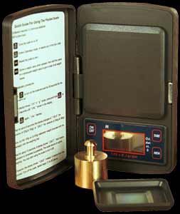

When buying measuring and weighing equipment it pays to do a little research. Generally speaking if you are going to do this with any degree of accuracy, don't waste your money on analog equipment. A good pair of digital calipers and a good digital jewelers scale will serve you fine.
I paid about $85 for my digital scale and it will fluctuate if you blow on the weighing area. It is a Pocket-Tech by Gram Precision.

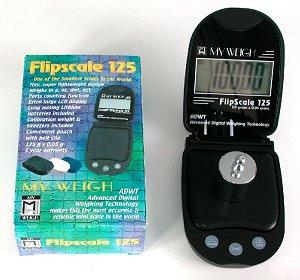

I have purchased the Flipscale 125 for $65 on ebay. It weighs up to 125g with an accuracy of 0.05g. With this accuracy of the scale, you can be fairly sure that you determine weight accurate to 0.1 gram. An accuracy of 1 gram is not sufficient for orders and medals. The Flipscale 125 comes with a calibrated 100 gram weight that is used for an automatic calibration procedure everytime the scale is turned on.

I bought the flipscale as well, but I find it's simply impossable to weigh a medal acurrately without including the weight the suspension. I think a digital caliper is actually more use, for measuring diameter and thinkness.
