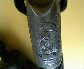

Looking into the Shaska and all that is been written about it i would like to add the following.
Shaska sabres were kept in the family and used from father to son. When part of the Cossacks in 1917 sided with the Communists they were called "Red Cossacks", while others were called "White Cossacks".
We know who won this civil war, and the "White Cossacks" were stripped of all belongings and imprisoned/executed or fled Russia any way they could.
Finding a Shaska with only the Imperial eagle on the pommel will have a good chance of coming from the 'White Cossacks".
A Shaska with a "Hammer and Sickle" cymbol and the C.C.C.P. markings will be a captured one or one used by the "red Cossacks".
Making the Imperial eagle dissapear on the pommels of Shaska sabres in use was symbolic for the communist revolution, but to fabricate new pommels and to exchange them for the imperial type was not an issue in the first years of the U.S.S.R.
It is more likely old stock was used and when finished a new type without any markings was introduced. Reminders of the Imperial realm were most likely abandoned as soon as possible. Therefore it seems unlikely that a Shaska produced in the 1930's would still bear an Imperial eagle underneath the hammer and sickle symbol. Of course blades get busted and have to be changed, which could explain newer blades on old handles.
Many of the "White Cossacks" joined the German army and fought aganist the Red Army in world war 2.
They were issued new Shaska sabres, made in Solingen and with mostly brass grips. It is likely some amitained the Russian imperial marked Shaska, why change a good Sabre?
There was a Cossack community in Italy towards the end of the war. In 1945 these Cossacks were extridited by the allied troops to the red army and many were slaughtered in Austria or send to the labourcamps in Siberia. German Shaska sabres and jewel and gold prize sabres went missing during this period, most likely ended up in the hands of English soldiers or local citizens.
One point on old swords , knives guns and especially sabres ( favourite) : Cleaning is fine, but taking away the patina layer and making an old weapon shine like new is somewhat of an abuse. The patina layer is what makes a weapon genuine and gives it the respect of old age, while a shiney new looking weapon of a 100 years old loses al lot of attraction. Sometimes making things look new is not an improvement.

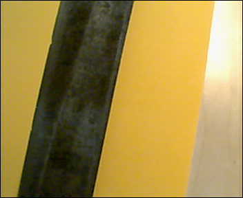

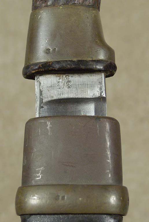

and some more. Note markings on handpart and blade, can anyone decipher these?

Erick Wrote:and some more. Note markings on handpart and blade, can anyone decipher these?
After repair in the army’s shop blade and scabbard were adjusted to fit each other. They were marked with matching numbers like examples below. Letters Г and M (or any other for that matter) are technological markings. Please note letter M on all brass parts.
15 КГ is result of the test done on the blade
